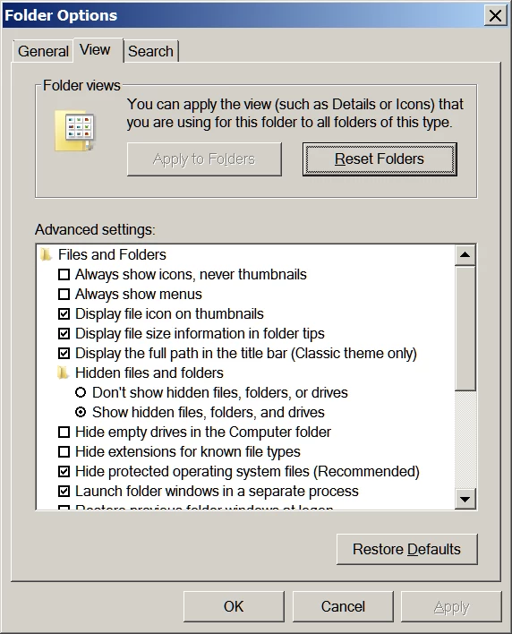

    Mar 23, 2012 4:39 PM UTC
    Darrin,
    I think you need to do this. Go to Control Panel, Folder Options (I have my control panel set to View by: Small icons.)
    On the View Tab, pick Show hidden files, folders, and drives. I doubt your admins have restricted this. If they have you live in a real Police State.
    [cid:image002.png@01CD08D8.C8D36DF0]
    David Haigh
    Mar 23, 2012 4:44 PM UTC
    David,
    Thanks for the tip, but mine is already set up to show hidden files,
    folders and drives, and yes, our IS department does have it controlled to
    that level, I'm pretty sure.
