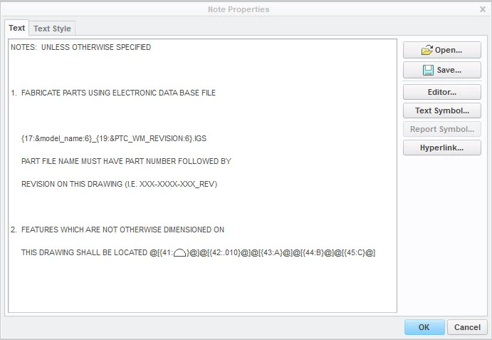

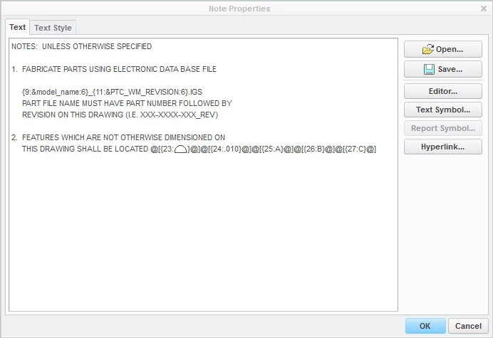

    Yes, the line breaks can be removed from inside the Creo editor. While it
    is not a show stopper it is quite a pain. My advice is do NOT use the
    text editor. Here are images of a note before and after hitting the
    "Editor" button.
