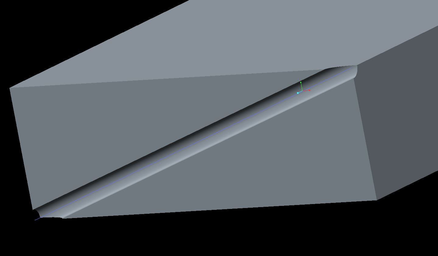

Making a hole diagonal of rectangle
hey there guys...this is nothing to do with d original post up there..
i just had a problem n i m looking for somebody to sort it out for me..
I WANT TO MAKE A HOLE ALONG D DIAGONAL OF RECTANGLE IN PRO-ENGINE
see if anybody could help me out

    Two ways of making holes when you do not have a good surface for placement:
    • Create a plane where the hole can be placed and located.
    • Create a revolved cut in the shape you require. You can later add a cosmetic thread in the hole if desired.

    Like this?
    Patriot_1776
    Nov 21, 2013 7:22 PM UTC
    Gotta create an axis and datum (on the fly to bury these features if you wish), then remove the datum reference first, then re-select the axis, THEN the datum (a pain), but it works and is pretty easy.
