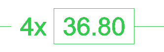

@[ can be used to draw a graphic basic box around a value. Like this: @[@D@]
Is there an equivalent for the inspection box also referred to as a "sausage"? I can't seem to find it if there is.

Let me clarify.
If you use the "Inspection" or "Basic" radio button everything is put inside the box. (That's how I made the images I showed).
But what if you want to do something like this:
You can type add a @[ and a @] around the dimension and type the 4x in front of all of this.
How do I do this with an inspection sausage?
