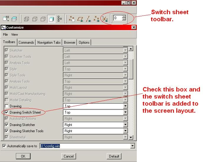

    Jul 25, 2007 1:36 PM UTC
    Bill:
    Just out of curiosity ... why would you need a mapkey when Pro Engineer
    has the following functionality (see attached)
    Jason
    Jul 25, 2007 2:22 PM UTC
    Bill
    I usually just type in the sheet number in the box, It's a bigger
    target!
