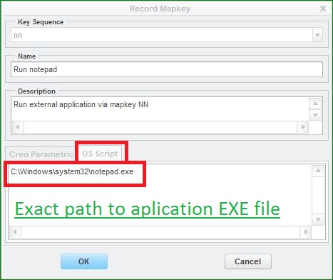

Sep 16, 2013 11:34 AM UTC
This reply doesn´t solve your "CTRL" problem, but take it like an extra information.
Run external aplication via mapkey:
l hope it can help somebody, sometimes...
