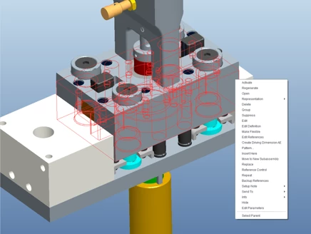

All,
Does anyone have a mapkey that opens a model that has been selected on the screen? I'm using Creo2 and I can't seem to make a mapkey for this that works.
When I pick a model it's a pain to have to right-click and then mouse to the "Open" command.

    TomU
    Aug 8, 2014 7:33 PM UTC
    Creo 2
    mapkey $F4 ~ Activate `main_dlg_cur` `OpenModel`;
    Creo 3
    mapkey $F4 ~ Command `ProCmdOpenModel@PopupMenuGraphicWinStack`;
    Feel free to change to a different key.

    I found that the open sequence given by Top doesn't if there is a FT as Creo uses a different command to open if generic. In order to open the model in either situation the single mapkey "e44" (or whatever you choose) can be used for both situations (which uses 2 intermediary mapkeys "openng" & "openg"):
    mapkey openng @MAPKEY_NAMEOpen generic modle (%e44);@MAPKEY_LABELOpen;\
    mapkey(continued) ~ Activate `main_dlg_cur` `OpenModel`;
    mapkey openg @MAPKEY_NAMEOpen (description);@MAPKEY_LABELOpen;\
    mapkey(continued) ~ RButtonArm `main_dlg_cur` `PHTLeft.AssyTree` `node10`;\
    mapkey(continued) ~ PopupOver `main_dlg_cur` `ActionMenu` 1 `PHTLeft.AssyTree`;\
    mapkey(continued) ~ Open `main_dlg_cur` `ActionMenu`;~ Close `main_dlg_cur` `ActionMenu`;\
    mapkey(continued) ~ Activate `main_dlg_cur` `OpenGenModel`;~ Activate `open_instance` `open`;
    mapkey e44 @MAPKEY_NAMEOpen non-FT model or generic if FT;\
    mapkey(continued) %openg;~ FocusIn `UI Message Dialog` `ok`;~ Activate `UI Message Dialog` `ok`;\
    mapkey(continued) %openng;~ Trail `UI Desktop` `UI Desktop` `PREVIEW_POPUP_TIMER` \
    mapkey(continued) `main_dlg_w2:PHTLeft.AssyTree:<null>`;~ Activate `UI Message Dialog` `ok`;
    This works in Creo2 but have not yet tried it in Creo3.
