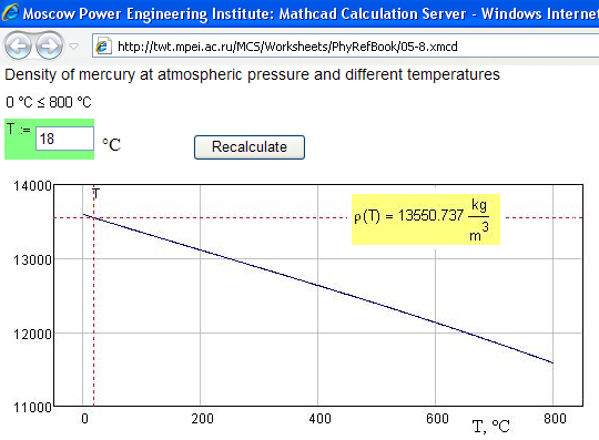

    Material Density is a function of temperature (and pressure too)!
    See one example
    http://twt.mpei.ac.ru/MCS/Worksheets/PhyRefBook/05-8.xmcd
    See the screenshot too:
    Aug 3, 2011 9:02 AM UTC
    Well, the data is given for near room temperature .

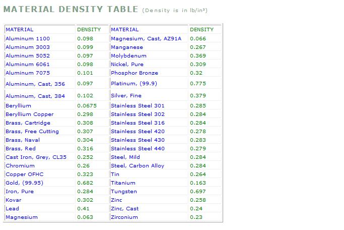

    Thank you all for the help. I also found a neat little list online while searching for materials.
