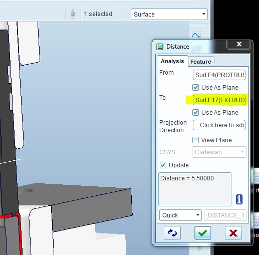

I'm new to Creo 2.0 (From 2001) and I need to measure between two planes.
So far, I've had no luck using Measure Distance. Can anyone help ?

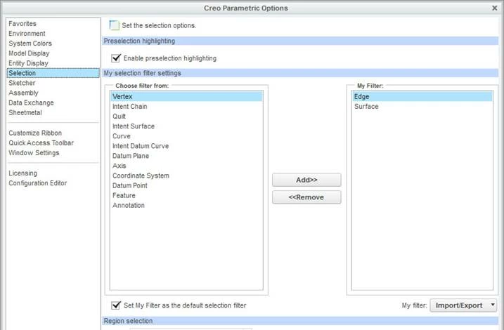

    And if picking items is a pain, (since I hate the Smart filter, and Geometry give me too much) you can create your own from File/Options/Selection. In fact, it can be different for part modeling and assembly modeling. In the image below is how I have it set for part modeling, and for assemblies I have it only set for Surface. It makes picking things for measuring and copying much easier.
    [cid:image001.jpg@01CD9D60.3E969690]
    The only enhancement I would add to this, is to have multiple "My Filters" with the ability to name them whatever I want. I'd definitely separate these (surface and edge) if I could.
