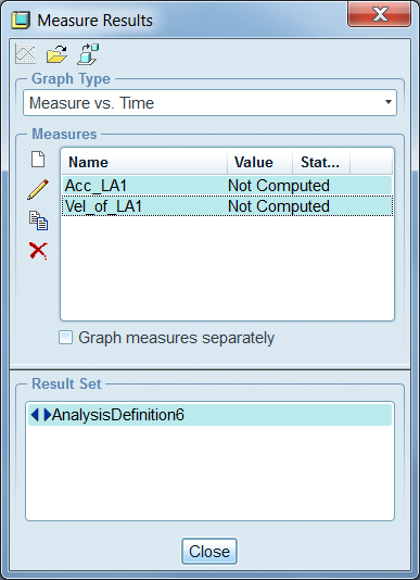

I have tried every combination of selecting measures and a result set but cannot get the graph icon at the top to become enabled so that I can actually compute the measures.  I take it I am missing something obvious.

    So it does report position measurements correctly, looking into what limitations there are for determining the velocity and acceleration

    Run the analysis again, I believe that some measures need to be defined before run the analysis.
    Apr 22, 2016 7:18 AM UTC
    I see that you want to measure velocity an acceleration, so I guess you have to run the analysis as dynamic.
    Did you run it as a dynamic analysis?
    Apr 29, 2016 3:54 PM UTC
    Try running a kinematic analysis ... default is position.
    Apr 30, 2016 1:31 AM UTC
    If you do not have the mechanism dynamics extension, there are a lot of invalid option here.  If it is valid, it will show up as computed.
