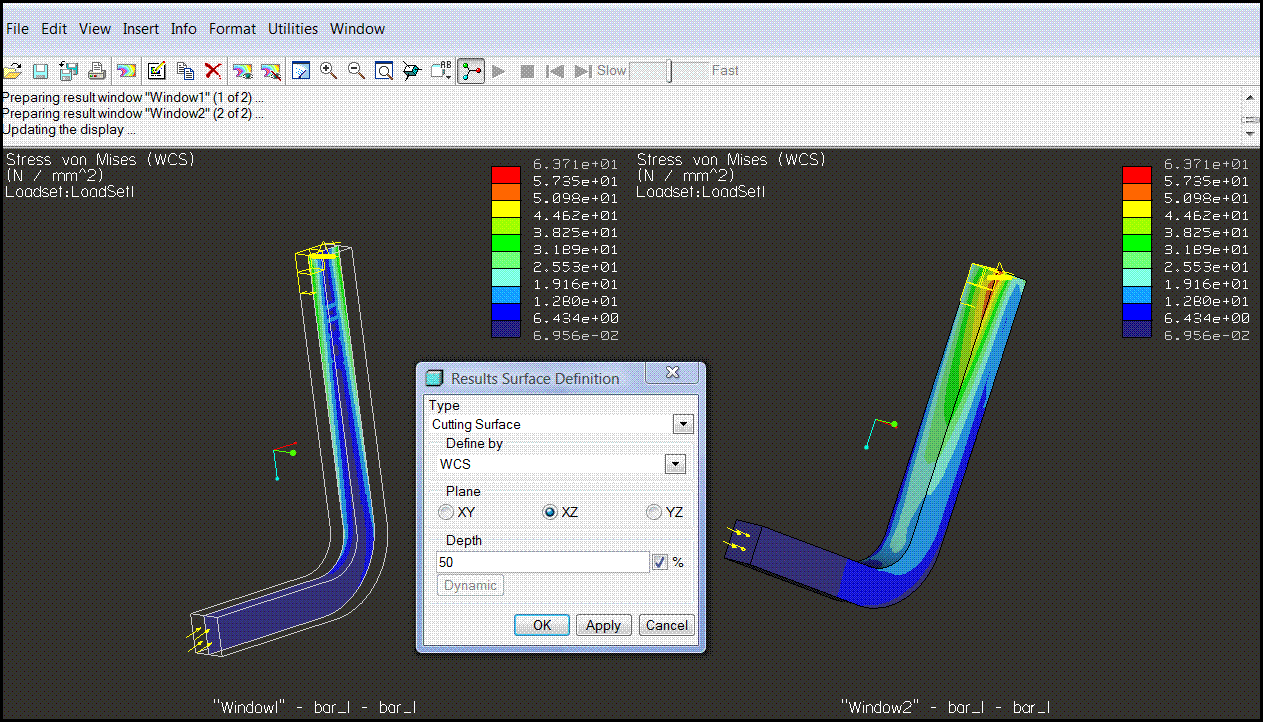

Is there a way to view the results of an analysis as a cross-section through the body/bodies? I'd like to see the distribution of stresses inside the solid body.... Thanks, Kieran Coghlan.

    Thanks Richard! Yes, I did get the analysis to run. There were other problems, for which I placed a tech support call, and Mark Fahlbeck with tech support helped me solve. This is a good forum. I'm lucky that my employer pays for full tech support too, but I prefer a forum like this, since it's open to everyone. I use tech support when the matter is more urgent. -Kieran
