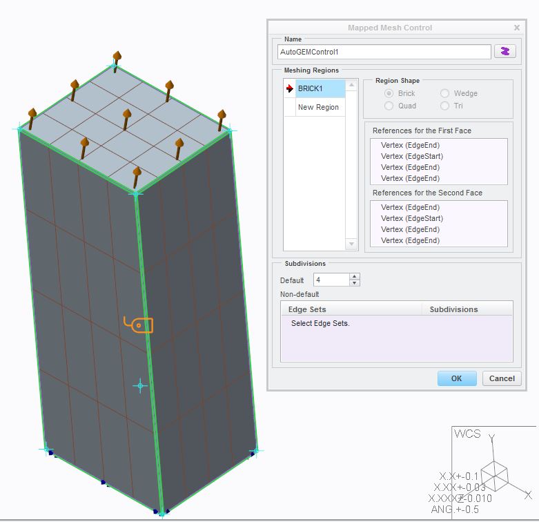

I would like to know how can I create 8 nodes and 16 nodes element in meshing.
under "control mesh" I have searched but I could not find anything like that, so can anyone help me with this? Thank you in advance.

    Have you tried a mapped mesh? You can specify brick elements that way. Creo 2.0, Refine Model --> Control --> Mapped Mesh.
    Aug 5, 2013 8:08 AM UTC
    You can insert a mesh control through Autogem -> Control... (at least in Wildfire - it may have moved in Creo.)
    There are several types, including Edge Distribution (number of nodes along a selected edge), Maximum Element Size (self-explanatory) and Edge Length by Curvature (very useful for parts with varying fillet radii).
    Under Autogem -> Settings... you can choose different element types including tetra (4 nodes), wedge (6 nodes) and brick (8 nodes) but I'm not quite sure what you mean by "16 nodes element". I've also had no success trying to automesh with anything other than tetra elements - you can select brick or wedge, but in my experience it either ignores this and just uses tetra, or it fails with an error message.

    Thank you so much for your kind response! I have tried controlmesh, settings, surface and volume mesh thoroughly but I could not attain only the brick elements, If I select, brick option along with it wedge and tetra also creating.
    Also I created a volume on the part of the assembly, then selected the edges of the volume and gave number of nodes but mechanica keeps the nodes I created and along withit, it also includes its own nodes that too the elements are not in brick, only in tetra.. If you want I can post a photo copy.
    So is there any possibility to obtain brick elements in mesh?
