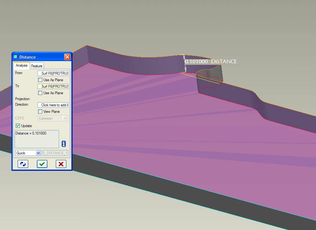

Hi Gurus out there.
I'm working with WF3 M090,
And I'm triing to misure a distance between 2 parallel planes.
Should be quite easy.....
Does anyone know a trick to get the USEFULL OLD(WF2) interface ?
Everytime I get an proiected_by_I_dont_know_what_####_plane distance
that is perfectly unusefull....
thanks in advance
    Jul 2, 2007 1:22 PM UTC
    With M090 it seems pretty easy - pick two planes and get a measurement. See the attached picture. If you want to enforce using the feature as a plane select the Use As Plane selection. If you are seeing a projection you must have a Projection Direction selected.

    if the planes are parallel, it should give you a correct dimension - at least mine is working that way.
