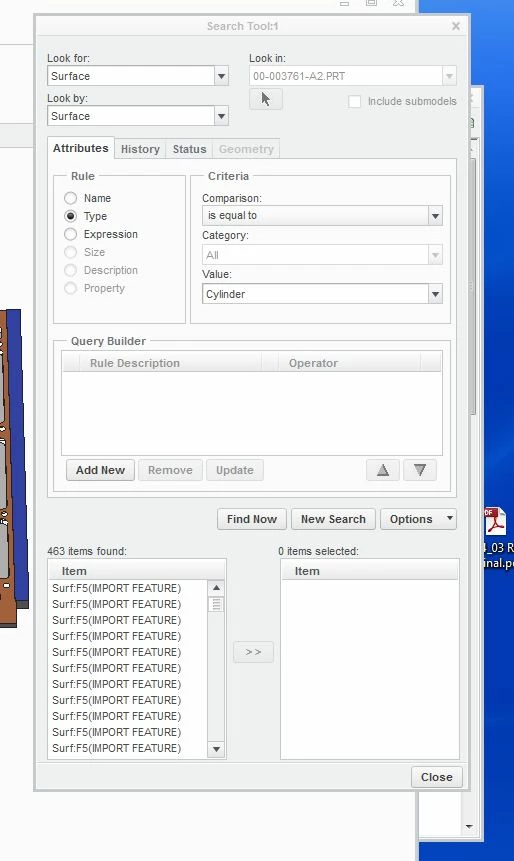

1) How can i search a model to, for example, find all inside corners that are < .1875.
2) Is there a way to quickly find the Length, width, and height of a model without having to measure each one.
I have attached a screen shot showing where i am at to this point. Any feedback would be appreciated
Thank you
Jim

    Thanks for the quick reply Nick. Yes, this works to give me the absolute smallest (or biggest) radius.
    I am trying to use this information to tell me what the smallest end mill will be. In my previous attachment the results i got are close but i need to be able to refine the search by using some size criteria but i am not sure what options to select.
    my second question has to do with material take-offs. It would be nice when quoting a job or ordering the material to be able to click a button and get the envelope dims of the part. the closest thing i can see is the model size command button under the analysis menu. it looks like this just gives you the diagonal though???
