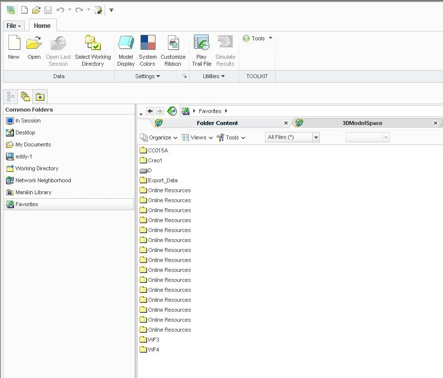

Anyone out there have multiple copies of "Online Resources" in their Favorites list? I'm not sure when the list got this big - but it's there & I can't remove the Online Resources folders from the list (screen shot attached). They're all the same, so I only need one of 'em!
anyone know how to get rid of 'em?

    If you can find the web_faivorites.xml file you can edit out what you dont want. It is hidden and usually in your C:\Users\xxxxx\AppData\Roaming\PTC\ProENGINEER\Wildfire\.wf\.Settings

    Thanks Nick - There were a couple of .xml files with the same name (probably for the different versions of Pro that I have installed). I found the big one and trimmed it back to a normal size.
