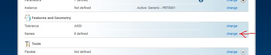

I have a sketch with several coordinate systems in it.  Once the sketch is complete, I want to change the name of those coordinate systems.  I know that I've done it as late as in Creo 2, but can't find the command in either Creo 2 or Creo 3.

    Hi Doug, i think you can do this through file/mass_properties

    That's it, although technically it's File > Model Properties.
