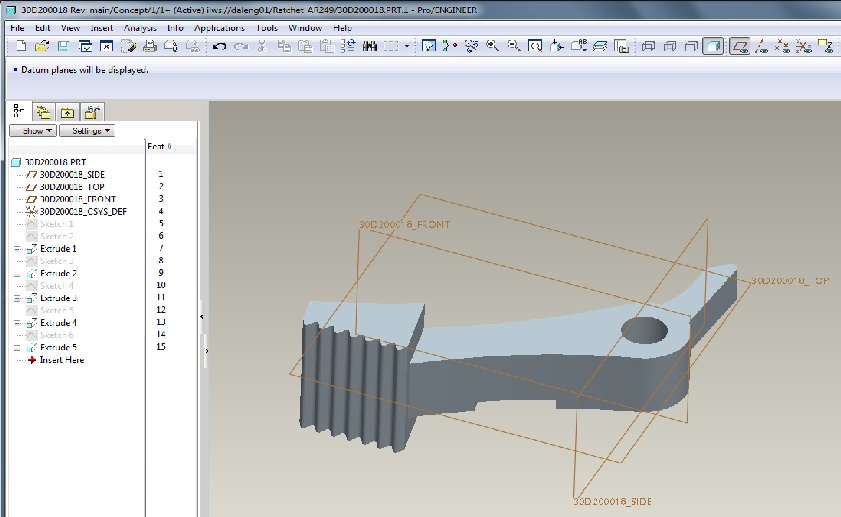

    GregMerz2-ExplorerAuthor
    2-Explorer
    Dec 29, 2011 2:27 PM UTC
    Brian,
    Here is a pic.
    Thanks for your willingness to help, greatly appreciated!
    Dec 29, 2011 4:02 PM UTC
    Hi Greg....
    These are already renamed.... but I can assume your start part calls those fikrst 3 datums "Side", "Top" and "Front", correct?
    2-Explorer
    Dec 29, 2011 5:34 PM UTC
    SORRY FORGOT WF4
