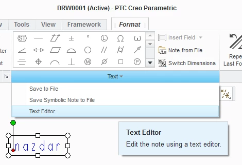

Oct 1, 2014 10:56 AM UTC
Joe,
I have found Text Editor command. See attached picture.
Martin Hanak
TomU
Oct 1, 2014 11:19 AM UTC
This is not the old editor. For me it just opens notepad!
