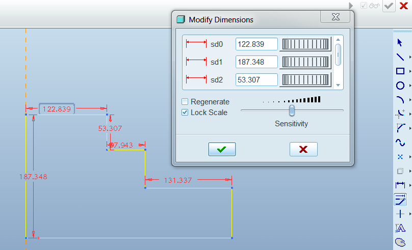

    6-Contributor
    Mar 12, 2012 6:37 PM UTC
    It is something you end up getting a feel for. But you can always sketch your profile, select all the auto dims created during your sketch. select modify dimensions lock scale...change one dim and the others will conform relatively..

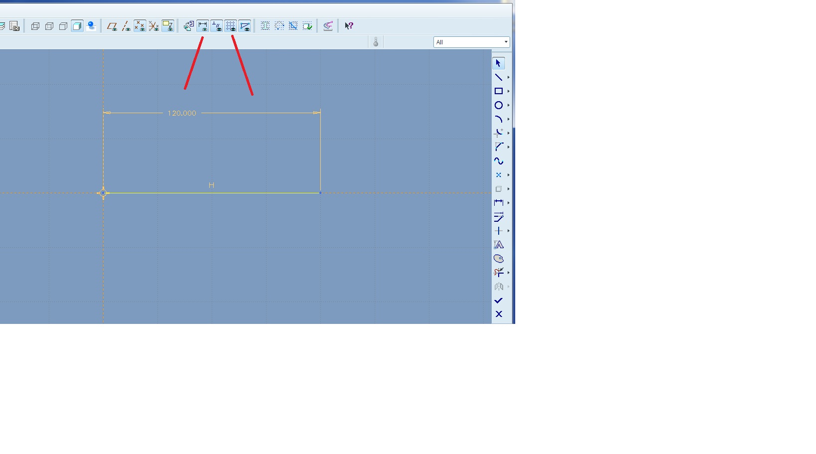

    Mar 14, 2012 10:39 AM UTC
    Richard,
    I'm in WF5 right now, but this functionality has to be similar in Creo.
    1) Turn on the display of dimensions in sketcher. This will show all dimensions of the geometry you create. If this button is not visible once you go into sketcher, go to the TOOLS > CUSTOMIZE SCREEN > COMMANDS and go into sketcher categories and then find that button and drag it to your sketcher toolbar.
    2) You can also turn on the grid in sketcher, which will give you a scale to start off all your sketches. The grid I show is made up of 30mm X 30mm squares. There are default values for this or you can go into the config options to set your own values.
    sketcher_set_grid_x_spacing
    sketcher_set_grid_y_spacing
    Hope this helps.
