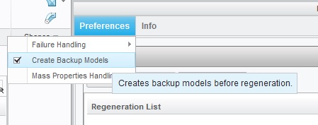

    Thank you for the post.  We recently upgraded to Creo 3.0 and when I went to choose a Backup Model there was no Backup Model to choose from.  I played with the option and just as the documentation states you must checkmark "Create Backup Models" at the beginning of each session if you think you may need a backup.  Who does not want or need a backup model?  What were the programmers thinking?

    I went through a lot of trial and error.  It appears if you set the config.pro option "regen_backup_using_disk" set to "Yes", a backup model can be chosen/regenerated.  I tried a couple times and it has functioned.

    I just located a couple config options that might work?  The default to Save a backup to disk is "No".  I am going to change it to "Yes" and see if I can get a backup to regen?  I also changed "regen_backup_directory" to "C:\CREO_REGEN".  I am going to start a new session and make a part fail to see what I get?

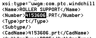

    Well, the part is showing up in the Workspace, not the C:\Creo_regen folder like I said to do with the "regen_backup_directory" config.  I do not know if being able to choose a backup from the Workspace has anything to do with the part had been saved to the Workspace earlier.
    So, I am going to make a part fail that is not checked out or has been saved to see what occurs?  Creo is creating an _BAK and it is not going into the folder I designated:
    Empty "C:\Creo_regen" folder?
    I searched my whole HD for the file and  I can only assume it went into the Workspace as ?  I think it was being placed in my cache.  This file has the timestamp of when I asked for a backup to be created and it contains the part number.  So, I have not tried, but "regen_backup_using_disk" set to "Yes" appears to function.
