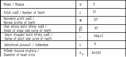

Pitch?
I ask you how you can calculate the helix teeth? Thanks
    Jan 14, 2016 12:28 PM UTC
    I am by no means a gear guy but.....
    Do you have any further basic information, like pitch diameter?
    pnos1-VisitorAuthor
    Jan 14, 2016 12:44 PM UTC
    1.jpg@

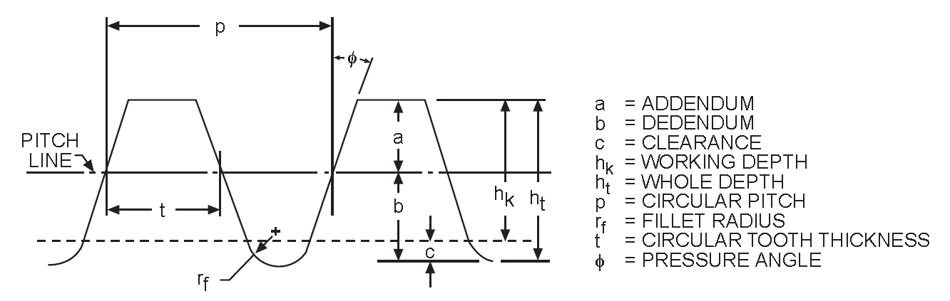

    Jan 14, 2016 1:37 PM UTC
    going to need more so...  suggest to go to the source of your step file and ask the questions but...
    assuming a helical spur gear (may need some modification)
    Here is what you are trying to find for the basic spur:

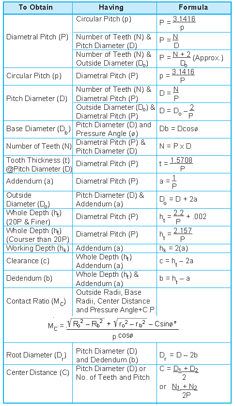

    This is what is needed to get there
    There is more for the helical part of the gear but this is most of the way there
