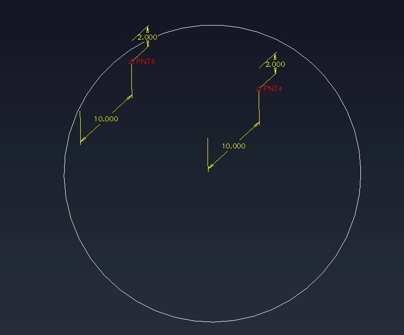

Attached pic shows why you need a 3rd constraint. The two points have the EXACT same constraints, yet are in two different places... Where is the other definition?
