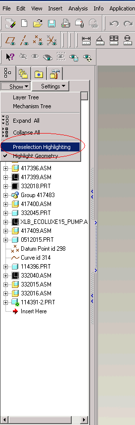

    Speaking of highlighting, is there a way to mouse-over an item in the
    model tree and see it highlighted in the main window?
    I'd like to do this when I don't feel like clicking RMB through 10
    planes and I want to "preview" my model tree selection before I'm forced
    to click on it (since a wrong click will force into many extra mouse
    clicks).
    Matt Gortner
    Dec 3, 2007 8:50 PM UTC
    Hope this is what you mean.

    Dec 3, 2007 9:04 PM UTC
    Yes, that's it. It's something I never needed until recently.
    Matt
    Dec 4, 2007 4:36 PM UTC
    Is there a config to enable this by default?

    Dec 4, 2007 4:52 PM UTC
    Yes, set this config option to yes.
    prehighlight_tree
    Hope it helps.
    Lucian
