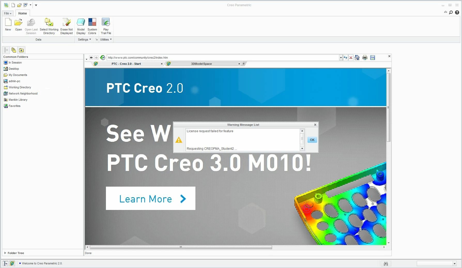

problem at startup
How to solve this problem occurred at startup

    This is an all too common problem for me but only when I wake the PC up from sleep mode.
    Has your installation worked or is this a new installation that gives this message?

    probably you have to restart lmadmin_ptc service. To do it run services.msc and find lmadmin_ptc.
    As Antonious said it is common when computer is woken up.
    You can also use simple script to restart service.
