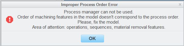

I have double checked all my Operations, sequences, and I'm not using material removal and I can't open process manager. How can I fix this?

    Hi, this already happened to me. This usually occurs when you reorder the sequences without the process manager. If this is the case, you should put the sequences in the original order, then open the process manager. Hope you remind it !

    Thanks. I'm too far along now to remember the original order. I did go through each sequence and edit step references and set the sequence to the correct operation, this didn't help.

    You could probably find the problematic sequence by inhibiting all sequences then reactivating them one by one. Then You launch the process manager between each reactivation and you'll find it. If you have many sequences, this can be heavy job !

    There is a document on PTC web https://support.ptc.com/appserver/cs/view/solution.jsp?n=126197
    I hope this will give you some information.
