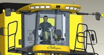

    Does Pro/ENGINEER Manikin allow you to change from 5th to 95th percentile male and female?
    > Subject: [proecad] - RE: ProE Manikin cost> Date: Wed, 19 Nov 2008 09:56:08 -0500> From: -> To: -; -> > All -> > Pricing varies by geography, but in the U.S., the list price for> Pro/ENGINEER Manikin is $2,995 and for Pro/ENGINEER Manikin Analysis is> $3,995.> > You should contact your Sales Rep or Reseller for specifics, of course.> > ~ Mike> > Michael M. Campbell> SVP Product Management, Desktop Products> PTC> 781.370.5039>
    November 19, 2008
    Absolutely! We support 5th, 50th and 95th percentile males and females
    for a dozen Populations (North American, Japan, Netherlands, etc.)
    We also support children and the elderly.
    Learn more about it here....

    November 19, 2008
    Yes, Doug. You are correct.
    There is a limited set of Manikin capabilities available in every Pro/E
    package (Foundation XE, Enterprise SE, etc.) as of Pro/E Wildfire 4.0
    M060 (due out later this quarter.) This basic capability will allow you
    to insert a "hypothetical" manikin (meaning he doesn't really represent
    any population/percentile, but he looks as you would expect him to.) in
    to your assembly, and posture using a reduced number of manikin
    manipulation tools him to get a feel for how he would fit. You will
    have access to pre-defined postures to help position him, but with this
    "free" set of capabilities, you cannot save the manikin in the design -
    we'll give you a warning when you first insert him in the design. Also,
    there are no population profiles to choose from, no reach or vision
    analysis tools (all available with Pro/ENGINEER Manikin Extension), and
    certainly no of the advanced analysis tools that are in the Pro/ENGINEER
    Manikin Analysis Extension (which needs a seat of Pro/ENGINEER Manikin
    as a prerequisite).
    This "free" version is a try-out. We believe that the Manikin
    technology is VERY compelling, and can help in a variety of design
    challenges. It's also "neat" to see a human figure interacting with
    your design, and we want each of our Pro/ENGINEER users to experience
    that.
    Beyond that "free" version, there are the two additional packages I
    mentioned. I hope that clarifies things.
    ~ Mike
