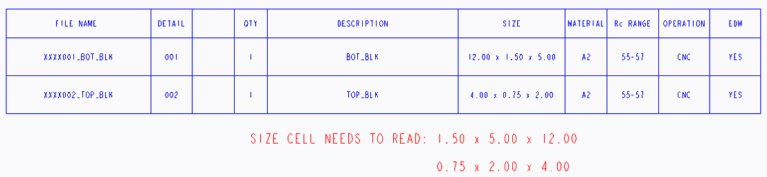

When dimensions are populated in a table file, I want them smallest to largest.  (Ex. 1.00 x 2.00 x 3.00)  I am unsure how to set up a relation to accomplish this.  I'm using Creo 3.0.  Thanks

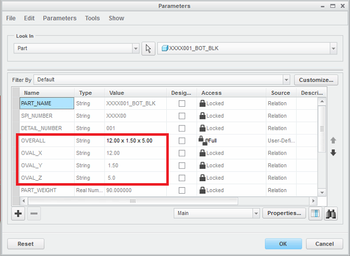

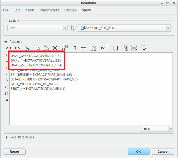

    I am attaching a small file which shows the existing relations and parameters.  As noted in the table the dimensions need to be arranged in ascending order.  By switching symbols you can see the 'size cell' is user defined and driven by 'OVERALL'.  A new relations statement needs to be created and I am unsure of the proper syntax that would populate the dimensions in the proper order.

    1.) OVERALL value is entered manually in every part
    2.) OVAL_X, OVAL_Y, OVAL_Z values are extracted from OVERALL using relations
    3.) your example model contains table and note
    4.) repeat region is sorted using values in DETAIL column
    5.) What do you want to achieve ? Maybe you want to show OVERALL value in SIZE column -AND- sort table rows using key1=OVAL_Y, key2=OVAL_Z, key3=OVAL_X ???
