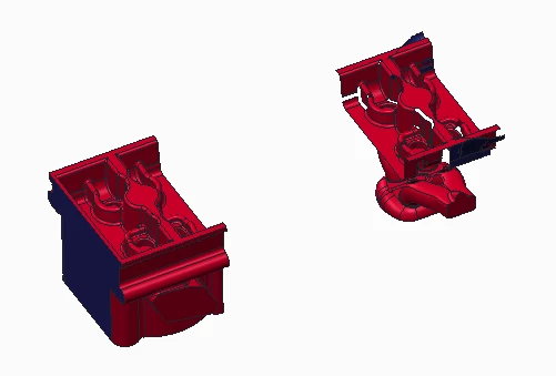

I downloaded the PTC World Car Dataset. Here:

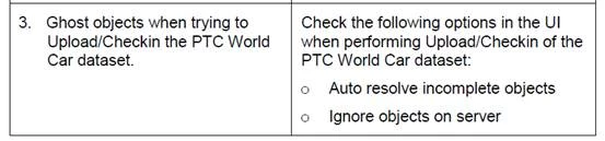

    Oct 30, 2014 11:10 PM UTC
    PTC acknowledges this in the Windchill(r) Creo(r) Data Management Performance Benchmark Test<">http://support.ptc.com/WCMS/files/130730/en/WindchillCreoDataMgmtPerfBenchmarkTest.pdf> guide. The solution is to simply override them when checking in.
    [cid:image001.jpg@01CFF475.25A253E0]
