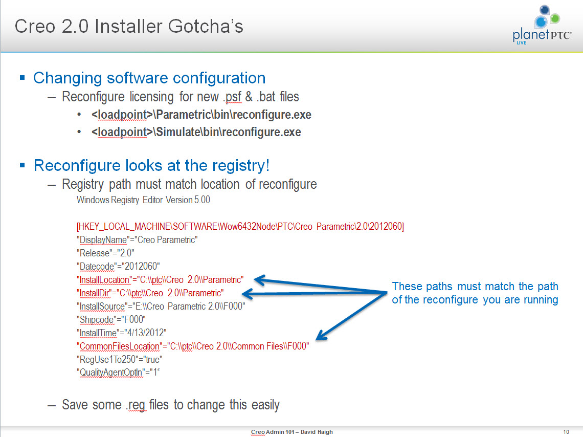

    Nov 20, 2015 1:33 PM UTC
    Hi
    I checked out Registry and they are OK
    and, unfortunately, the problem is still active.
    Thanks anyway
    Pier
