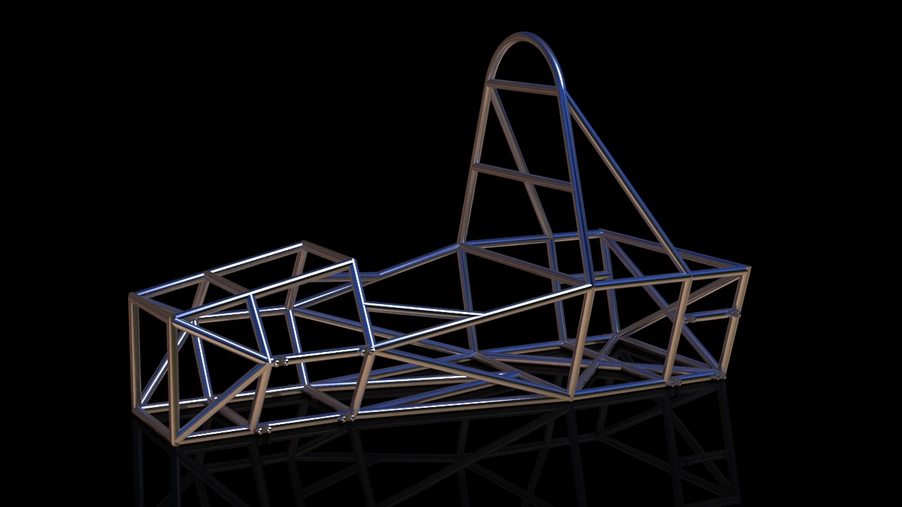

How to do frame work in CREO? i mean like modelling a roll cage of an automobile for correct allignment of the rods.. please suggest

    We have customers who have completed roll cages just like your picture using Advanced Framework Extension
    You can access AFX Standard using the configuration option afx_enabled to Yes and then re-starting Creo
