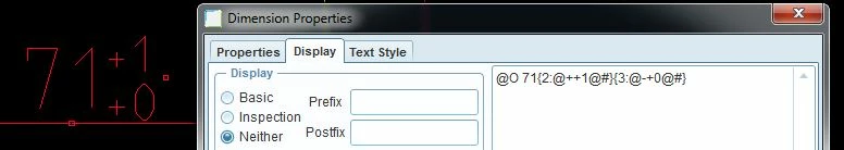

I created the below note by using parametric method. Now I need to remove the symbol infront of zero. Will any one help?

    You might see what different standards do. I thought ISO would remove the sign in front of zero.
    May 21, 2013 5:07 PM UTC
    Yeah, according to ISO, it should be without the plus sign.
    I have yet to figure out how to do this in Creo without overwriting the dim text. I usually just make it show as 71+1. So, in this case I would just put +1 into the sufix of the dim text, which is also fine according to ISO.
    May 21, 2013 5:32 PM UTC
    Maybe I don't understand what you mean by "parametric method". It appears you manually entered the tolerance in which case you can simply delete the "+" for the lower tolerance.
    If the tolerance was parametric, the dimension would only show as "@D".
    So it might be that you need to go into the model and re-format the dimension if in fact it is formatted in the model.
