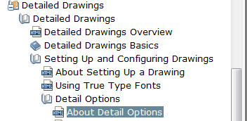

    Look in Drawing Properties/Detail Options.  Option "view_note" controls how the view name is displayed.  Value "std_din" omits the type of view.  Value "std_ansi" uses two spaces.  There are several other options, one of which may get you what you want.  This will only affect views created after the change.
    Jul 13, 2015 5:05 PM UTC
    Check the drawing detail options.  Search help:
    Find view_note.
    There may be other drawing detail options you must configure as well.
    Make your settings in a detail file.  To test them you must read them into the drawing.  They are copied into the drawing.  They are not read each time the drawing is opened.
    Once you have settings you like it's likely a good idea to update your drawing templates, and then make a map key to update your older drawings to suit if you need to have older drawings have their drawing detail settings updated.
