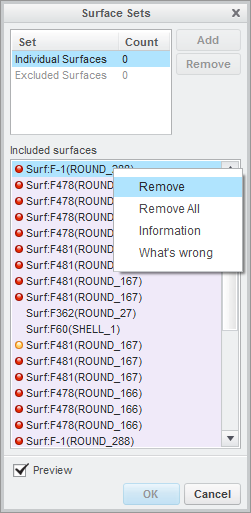

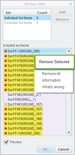

Please add the ability to select multiple included surfaces and or references in all dialog boxes (for all commands) and add remove selected command to popup dialog box.
Currently you have to select each reference separately and click the remove command. We should be able to select multiple items and remove them all at once.
Verified in Creo  Parametric 2 M150 and Creo Parametric 3 M50
Current Dialog box                                                   Proposed Dialog Box

    A big THUMBS UP for this one.
    When rebuilding a complex model and you want to keep one or two references but remove the rest...   There are few things more frustrating  than needing to "Right-Click, Remove" 20+ different times!!!
    Hope this gets approved!
