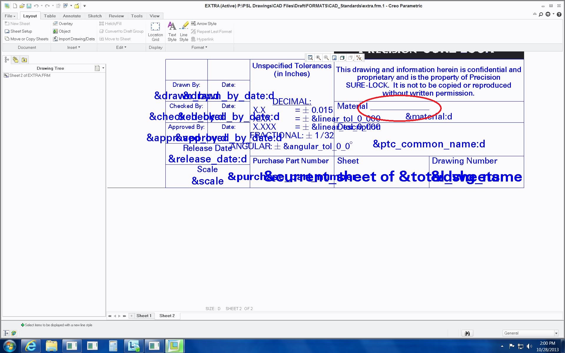

removing a line in the table
I cant figure out how to erase this line! Ive unmerged and merged several times and its still there.

    I think you have to blank that line, in case it's part of the table, and if it's not coming from the cell's content.
    Select the whole table --> RMB --> select Line Display --> then in menu manager pick Blank --> and then select the line.

    I'm sure you already checked, but it is not part of the annotation in the word material.
    (i.e. Material_________ )

    Oct 28, 2013 8:25 PM UTC
    Thank you it worked! I just wish I can do the same thing when I'm editing the format file.
    I just have to blank the line out everytime.

    my colleague uses Blank command in Format mode without any problem in any ProE/Creo release.
