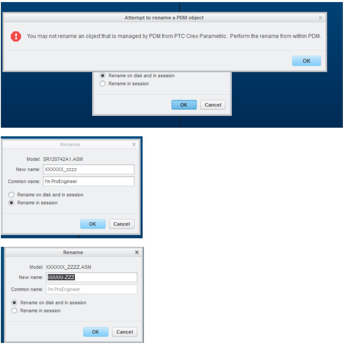

I am trying to rename an assy that contains a component that is controlled by Windchill.  I am not trying to rename the Windchill controlled component, only the top level assy.
However, Creo is blocking the assy rename because of the Windchill controlled component, which I'm not renaming.
How do I get around this?  I know I could set let_proe_rename_pdm_objects to yes, but I don't need (or want) to rename Windchill objects.
The Windchill system is the clients, not ours, and I have no access to it.

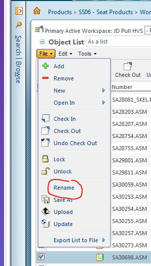

    Sounds like you are working in a windchill workspace.
    View the windchill workspace in the in-session browser, check the assembly (or part) check box and from the file menu select rename.  This should work if the part has never been checked in.
    Aug 11, 2016 9:04 PM UTC
    Nope, no Windchill at all here.  The file came out of the client's Windchill system and will need to go back into it once done.

    If you received a part or assy originally stored on Windchill and you don't have Windchill. You will encounter this error below for the rename function.
    Fix: Just rename all objects in session and than on the disk.

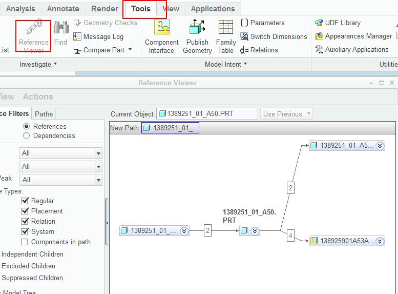

    I guess it may not allow you to rename because it might taking reference , can you please check the reference viewer once
