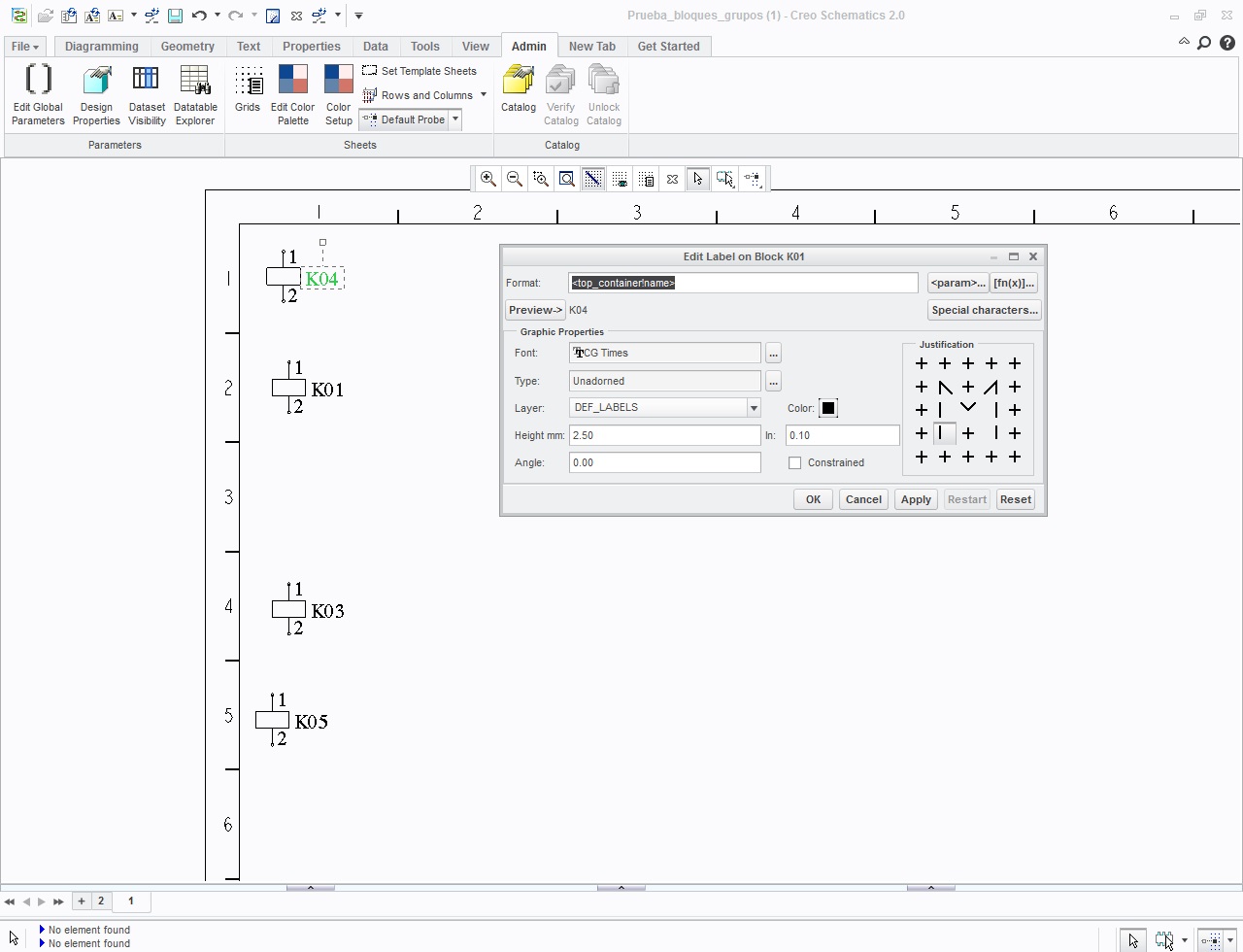

I would like to know if it's possible rename atomatically the names of the instanced groups. Here's an example:
I instanced 5 relays and deteleted K02 relay. I want rename automatically the other instanced relays to have from K01 to K04 . Is it possible?

    I found an incomplete solucion, but it is a good way reuse the deleted names.
    If you have for example K01-K02-K03-K04 and you delete K02, you can't reorder the names and get K01-K02-K03. But if you delete K02 and then click in Admin->Design properties->Reset Serial numbers, the next time that you instance a new "K element", you will instance K02 again, getting K01-K02-K03-K04.
    I hope this help.

    Hi.
    No. I want to rename the instanced elements of each group.
    If i have the sequence : K01. K02, K03 , ... K40. and i want to delete K02,then i would have K01, K03, ...K40.
    I want to know if its possible reorder the names and have K01, K02 ...,K39
