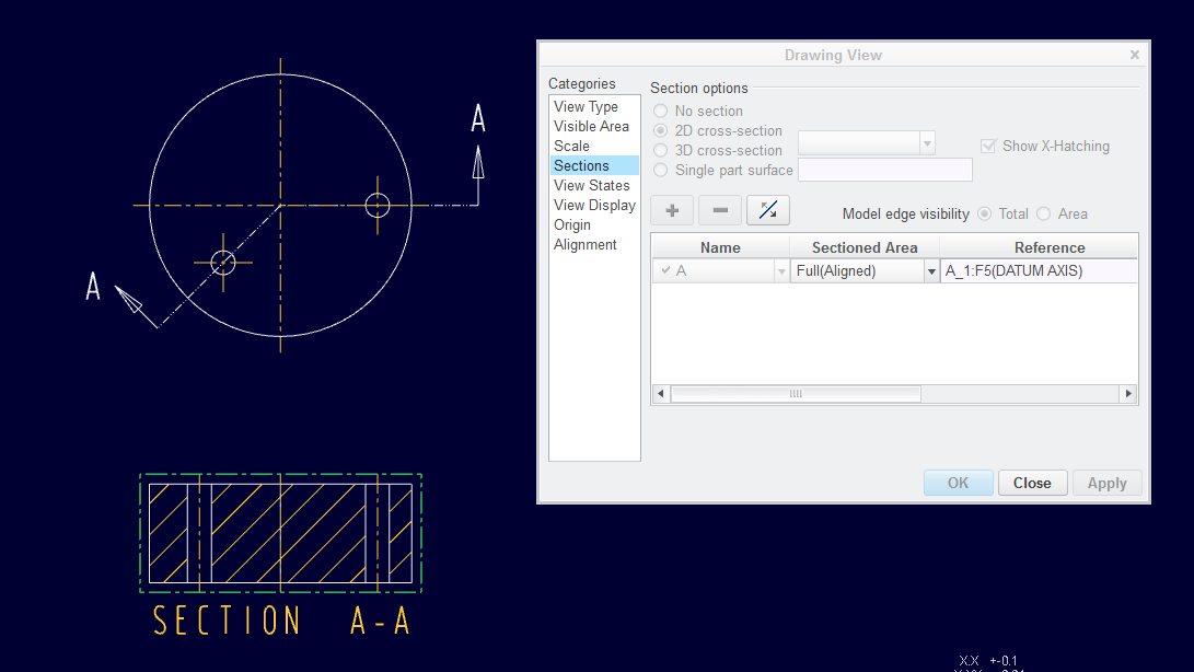

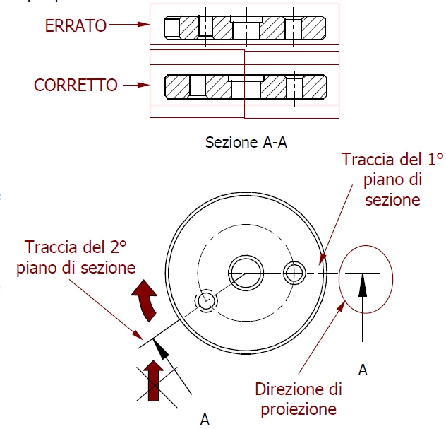

I'm a Creo 2 user and I'm having a problem with the representation of sections made with 2 planes. The attached image shows the exact problem I have.
The section is projected perpendicularly to the parent view and represents the component cutted. It should represent instead the section always perpendicular to the section planes.
Do you know how to solve this error?
Thank you in advance.

You need to specify "unfolded section"
Jun 21, 2013 2:12 PM UTC
Strange behavior for this style of view.
First; how are you defining this section? As an offset or a zone?
You need to do the offset section where you sketch the section in an open sketch.
If you have a parent view (projection parent) you get the option of Full(Aligned)
If you do not have a parent view, you get the option of Full(Unfold)
Jun 21, 2013 3:12 PM UTC
Thank you Antonius,
it has been very helpfull.
My section was an "offset" one but I didn't know the options "full alligned" and "full unfold".
I still have some problems due probably to some bad setting (the hatch is incomplete).
I'll try to solve them.
Thank you for the help.
