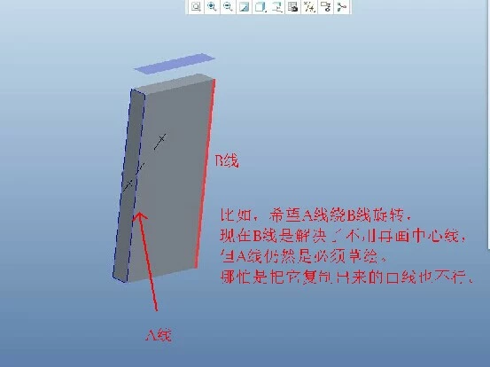

Revolve requires center line created in the sketch. why not pick some edge/copied edge for revolving operation

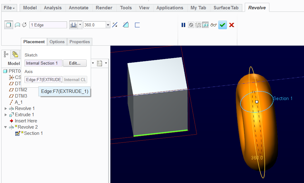

You can do just that in the revolve dialog. The axis does not need to be internal to the sketch.
