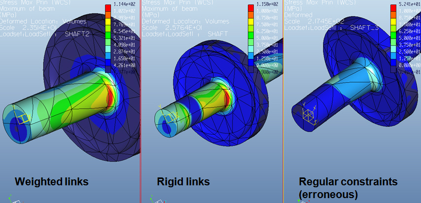

    Weighted link allows the reference geometry to deform, the rigid link does not. I'd use weighted link if I can (it's ony available in the advanced version of simulate).
    A limitation of the weighted link, is that you can't apply a constraint to the dependent point, but there's a workaround for that. This shouldn't be a problem in your case since you want to apply a mass.

    It describes three different methods to constrain a shaft subject to bending and torsion, using three different methods. I use regular constraints (erroneous), rigid links (correct, but yields unnatural stress distribution around constraints), and weighted links (correct, no unnatural stress distribution, but more complicated to create).
