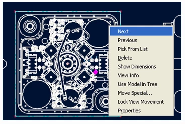

    I am facing a issue while making drawings in Pro-e (WF3, M230)
    I inserted a view and added its side views (selecting view and right click - insert projection view). And, did some work on other sheets.
    Now, came back to this view again and tried to insert one more projection view (bottom) and I am not able to get the link "Insert projction view". (see attached snap shot)
    Any clue?
    Thanks & Regards,
    Jnanesha KS
    T 91-80-4119 0900 Ext: 466
    F 91-80-41190901
    M 994 500 4179
    www.quest-global.com
    February 5, 2010
    Your image shows you have it highlighted over not selected, Select it
    and your projection should be available
