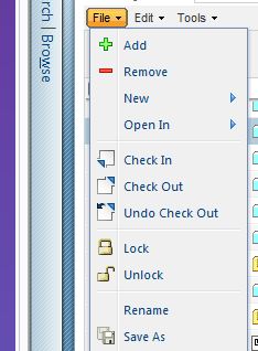

    First the item being copied and the parent assembly need to be uploaded or unmodified and the parent assembly needs to be checked out.
    Check the item being copied and select File/Save As

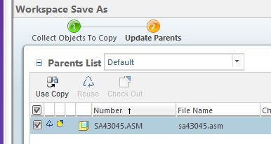

    Update name of copy and select next.
    Check the assembly to replace the item in and select Use Copy.
    Select Finish.
    If the parent assembly is "Struck Through", it is ineligible for some reason.  Hover mouse over red "i" to see reason, then cancel copy, fix issue, and start over.
