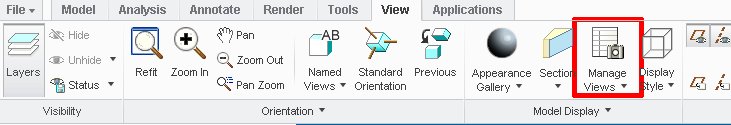

How can I save a specific layer status for later reuse?
In the combination view definition there is a drop down for layer status selection, see screenshot. However I was never able to create different layer status.
Any advice is welcome.

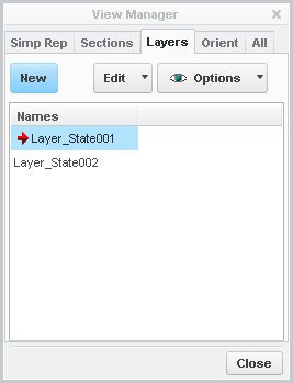

Sep 29, 2015 12:56 PM UTC
I think you need to define the layer states first. You can do this in the Layer tab in View Manager:

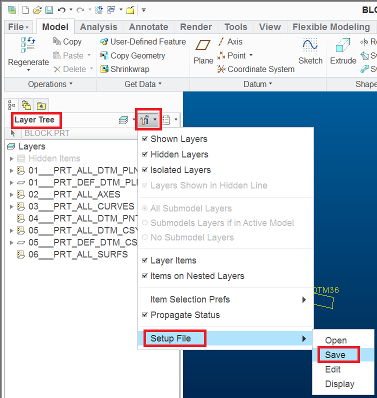

Sep 29, 2015 10:21 AM UTC
you can save current status of all part layers into layNNNN.pro file - see image.

Sep 29, 2015 12:31 PM UTC
Saving the setup file, doesn't give me more options in the combination view definition. See screenshot:
jgeling1-VisitorAuthor
Sep 29, 2015 1:09 PM UTC
This was indeed what I was looking for.
