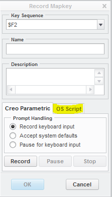

    I usually edit the mapkey directly, but you can also insert it from the Creo GUI.
    Here is the syntax:
    mapkey(continued) @SYSTEMZ:\\folder\\subfolder\\script.VBS;\
    I usually write in VBS, but as Doug pointed out above you can include .bat files or other executibles. I have not reviewed Doug's code, but you could take that paste it into a text file, modify as needed, change to script.bat (or whatever you need) and then put it into the mapkey (like shown above) where needed (presumably the end).
    You could then create another mapkey that just calls the first mapkey over and over as many times as you needed.
