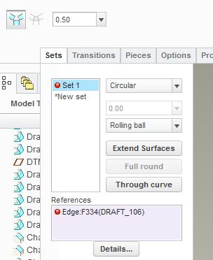

Hi.
I have a failed round on edge F334. See attached image.
Is it possible to search for and locate this particular edge?
I've tried using the search tool, but without luck.
Best regards
    November 5, 2013
    I think the F334 I believe refers to the feature number or ID, not the edge ID. Click the details button and you might get more info, but if the edge is missing you may not.
    Either way, the find tool (ctrl-F or on the tools tab) is your friend. It can take some fiddling, but it's very powerful. You can search for edges by name or ID, features by name, ID or number and much more.
    Inside the round tool, it's only goign to let yous earch for edges. Outside of it you can search for just about anything. In the tool, the history tab is where you can search by ID and number, the attributes tab is where you can filter by name or type (round, extruded, sketch, etc.)
    Good luck.
