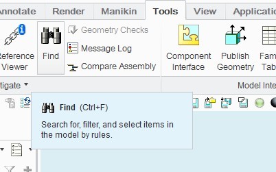

    Dec 16, 2013 1:43 AM UTC

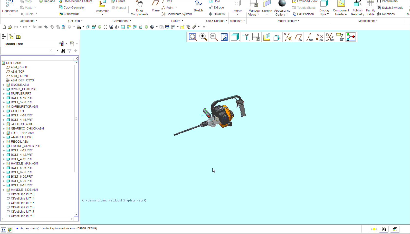

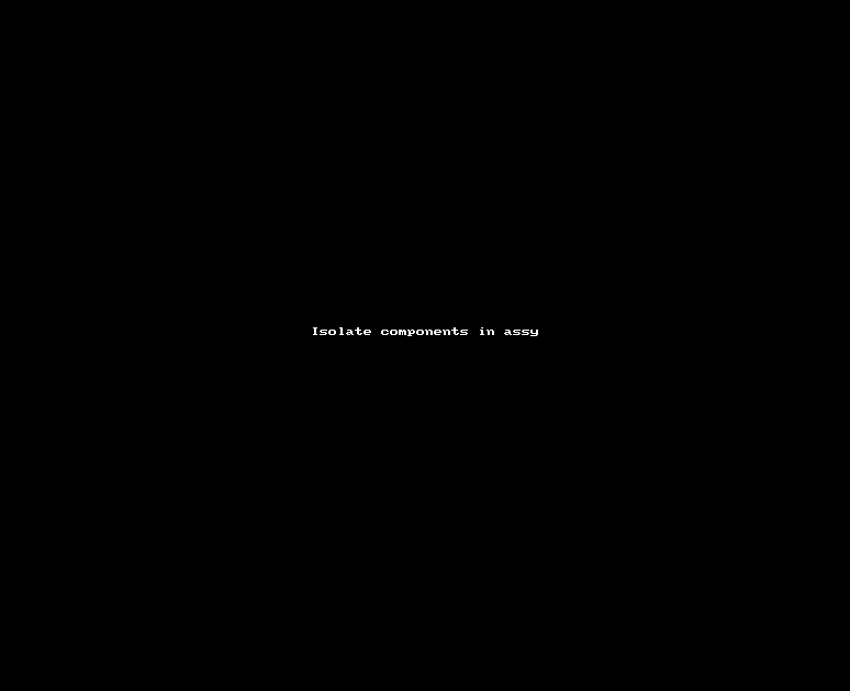

    What is lacking is, or maybe it's possible, a quick way to select some components in an assy in the window and isolate them.
    Dec 16, 2013 8:43 PM UTC
    For isolating components, you can:
    1 - Select Components (Graphic area, tree, find tool, etc.)
    2 - RMB->Set Representation To->Master.
    It only works if the simplified rep is unchanged, but is the fastest way I know.
