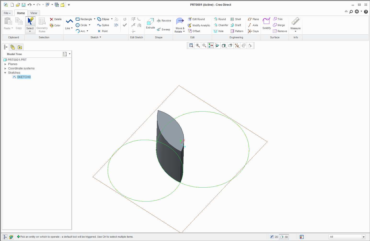

    You can do this in Creo Direct if its any consilation.
