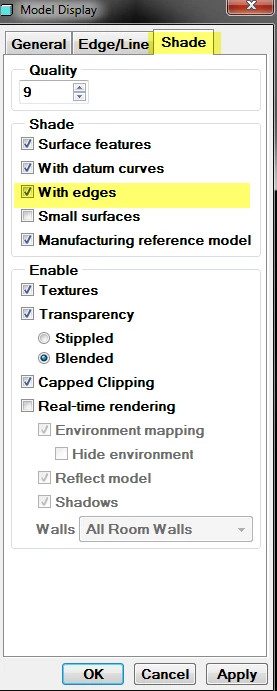

Shade with edges
Can you change the color for the edges when in shade mode? Black would be nice 🙂

    Art,
    I believe the trick in WF4 is to change the color of the part to black with the edges checked then go and change the color of the surfaces. This will leave the edges black. Black edges if needed are in Creo.

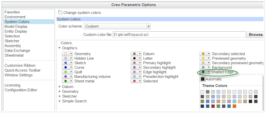

    Jul 1, 2014 5:23 PM UTC
    Starting in Creo Parametric you can choose the color of the shaded edge. Prior to that it was based on the color of the model.
    See CS42424 (

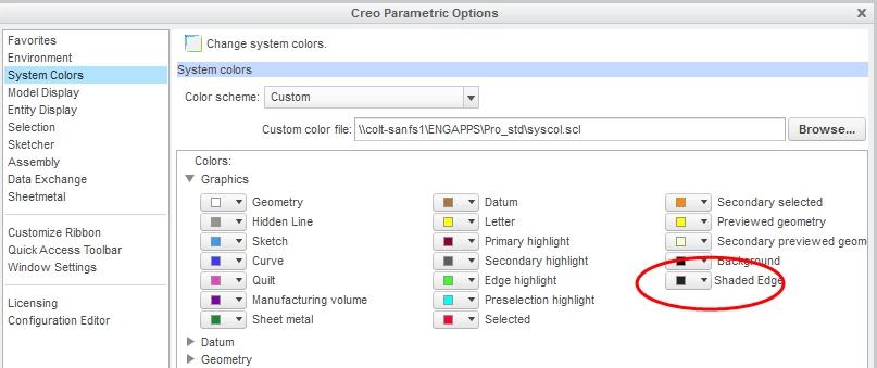

    Jul 1, 2014 8:09 PM UTC
    FYI - The Config option listed in PTC's resolution isn't valid.
    At least it wasn't for my install of Creo Parametric 2.0
    I had to put display shadewithedges in my config to turn on shaded edges as the default model display setting.
    Also - Something I've tolerated for a long time now was when I would load a custom_color.dtm file the edge color would change.
    I wanted it to be black but the only time it was black was if I was using the Creo default grey model color.
    Adding SYSTEM_SHADED_EDGE_COLOR 15.294118 15.294118 15.294118 to my personal SCL file sets the edge color to black for all colors in my .dtm
    Doesn't work as well for colors with transparency but it's much better than before.
