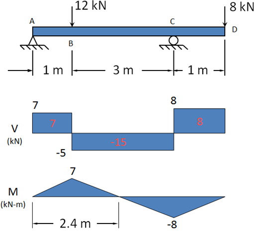

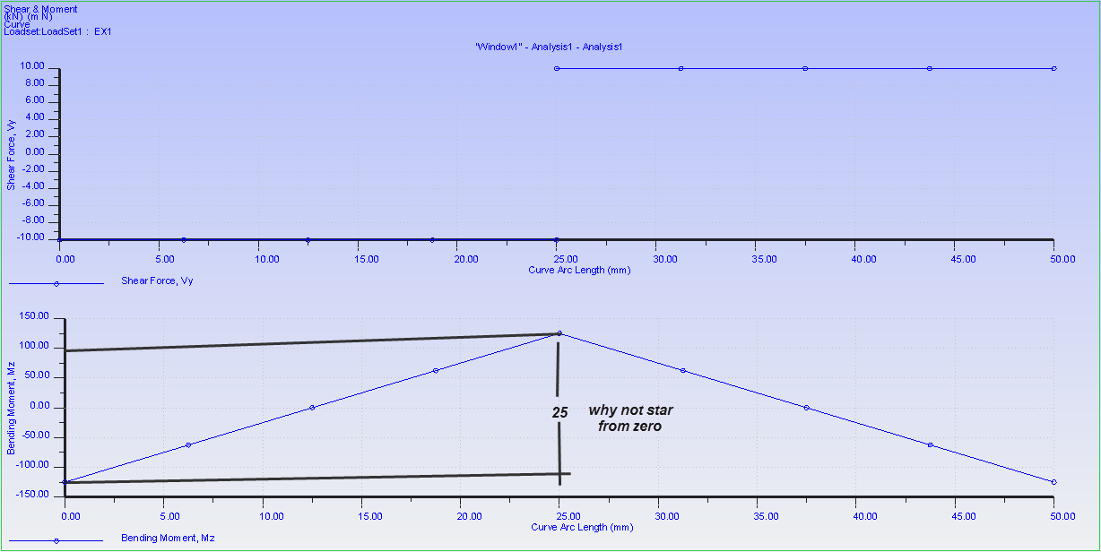

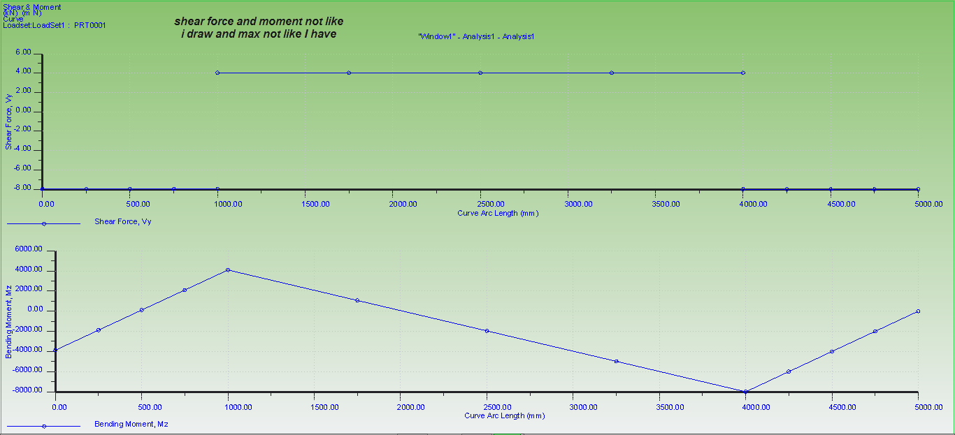

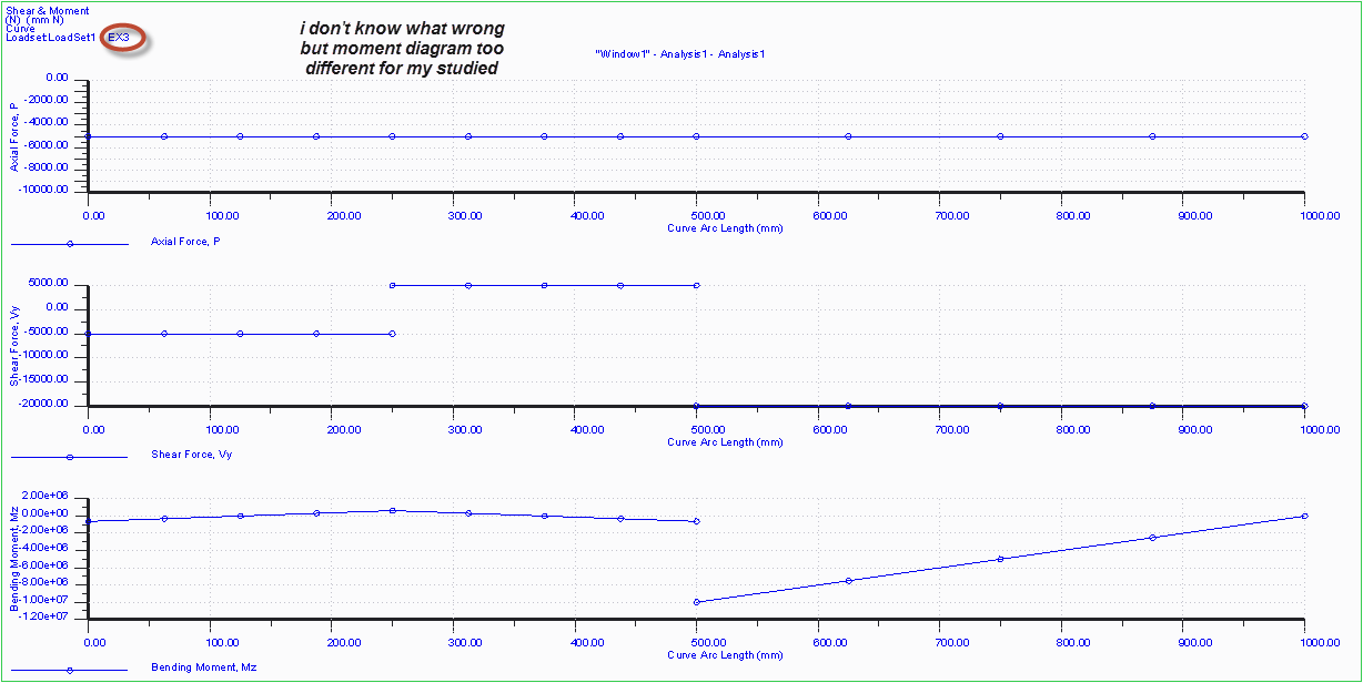

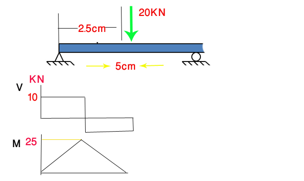

when i draw shear and moment diagram i have diagram not like diagram i study
and not like number
anyone can explain this graph
i have same shear diagram but moment diagram not start form zero
I don't know what wrong of moment diagram

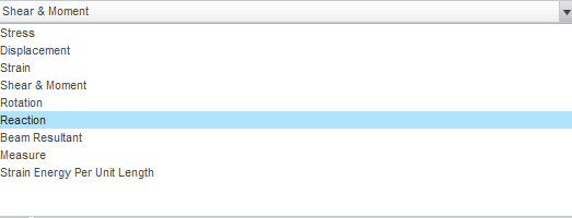

and can you help how i can use reaction graph

    In ex6.prt your constraint at the negative-x side have rotational degrees of freedom fixed. Rotation around Z axis should be set free to get M=0 at the beam endpoint. I have not looked at the other models.
