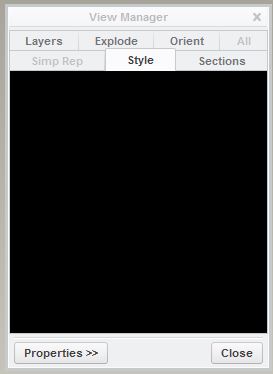

Simp Rep Not Working!
Can someone please help!
My simp rep does not work. It remains
greyed out what ever I do. It is only like this in Creo 2.In all previous versions I have it works fine
Help!
    Sep 9, 2014 5:23 AM UTC
    Alan,
    PROE_FoundationAdv license contains ASSY_PERFORMANCE module. This license enables you to create SimpRep in ASSY.
    PROE_Foundation license does not contain ASSY_PERFORMANCE module. This license does not enable you to create SimpRep in ASSY.
    Test:
    Launch Creo and click File > Help > System information.
    In License Information section check License Name line.
    If it contains PROE_FoundationAdv, then you can create SimpRep in ASSY.
    Your parametric.psf contains the following line:
    ENV=CREOPMA_FEATURE_NAME=PROE_FoundationAdv PROE_Foundation ()
    This means that Creo tries to get PROE_FoundationAdv license during startup. If PROE_FoundationAdv license is in use, then Creo automatically tries to get PROE_Foundation license during startup. If PROE_Foundation license is also in use, then Creo informs you that there is no free license.
    Try to change the above mentioned line to the following one:
    ENV=CREOPMA_FEATURE_NAME=PROE_FoundationAdv ()
    After this change you will always launch Creo with the proper license.

    Sep 8, 2014 2:38 PM UTC
    Alan,
    I guess that you can create simplified representation in a part and you cannot create simplified representation in an assembly. Is it true ?
    It looks like your startup command is not configured properly, it does not contain license code, which enables you to work with assembly simplified representations.
    Martin Hanak
    Sep 8, 2014 2:46 PM UTC
    Hi Martin.
    Yes. That's right. Can I get round this?
    Alan
    Sep 8, 2014 3:08 PM UTC
    Alan,
    if you want to check your license, you can click File > Help > System information and see the list of modules in Configured Option Modules section.
    If you open CREO2\Creo 2.0\Parametric\bin\parametric.psf in Notepad, you will see the same information in the line beginning with ENV=CREOPMA_FEATURE_NAME=
    I cannot give you detailed information how to solve your problem, because I do not know your licenses.
    Maybe you can compare proe1.psf (ProE Wildfire 5.0) with parametric.psf (Creo 2.0).
    Martin Hanak
