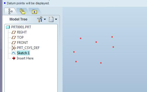

In WF4 you could get sketch points which could be used in EMX to put in mutiple bolts or ej pins. Is there a way to sketch a group of points in WF5?
    July 9, 2010
    I am not sure I understand, but in WF5 in sketcher you can switch the points to geometric points. Then you could have a sketch with just points in it.
    Like this:
    You change the point type here:
